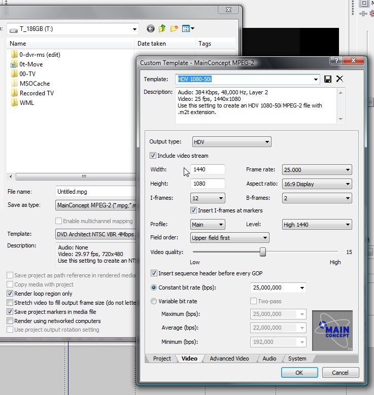

    This is how you do it in Vegas.

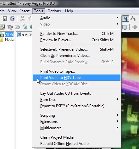

    Then there's direct print to HDV tape under Tools
