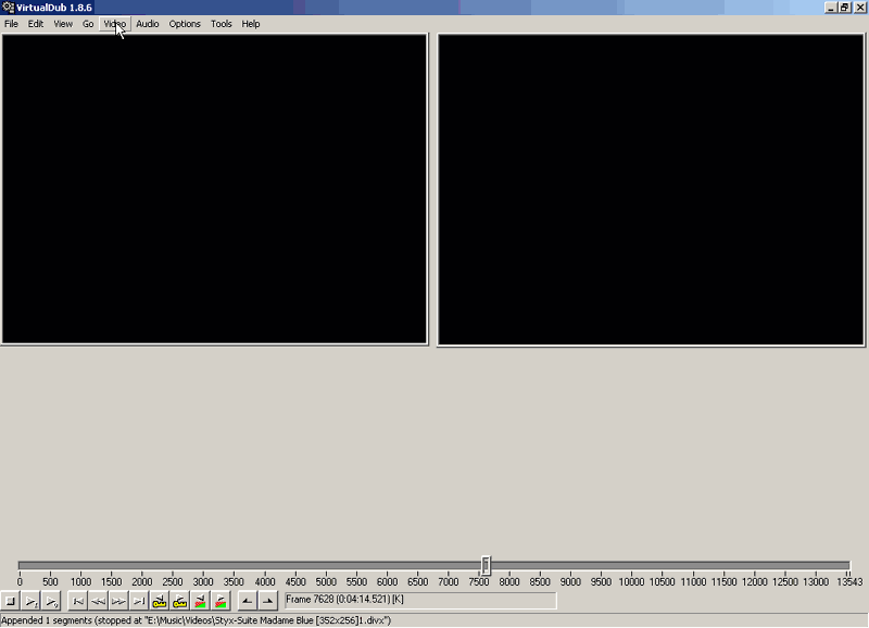

    If they are AVI files, then you can use Avidemux to join the files. Choose yes when it asks if you want to Smart Render. That way, it doesn't recompress the file.
    I use Virtualdub 1.8.6 and use the Fill filter in Blend Mode with the Curve Editor to fade in and out from black. Then I choose Full Compression > Compression > choose the codec that was originally used to compress the AVI > choose Smart Render > save AVI. This will Direst Stream Copy all of the movie except where you put the fades.
    I'll make a small guide and post it to show how it's done.

    Here's the Virtualdub guide. Make sure when you make the curve that you keep the outside points all the way to the bottom or you'll end recoding the whole clip. To set the points of the curve, hold down the sift key and left click the mouse. You can adjust the the points out as far as you need them to get the effect that you're looking for. If you need the black to stay black longer, you can add more points to the top.
