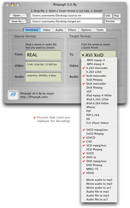

    1/ Drag-and-drop a .rm file onto ffmpegX. Try the [Play] button. It should launch mplayer and play the file. This should confirm that you have installed reallib correctly.
    2/ Reallib is a plugin for mplayer, so you will have to use a preset that uses mplayer for decoding, such as the mencoder presets (h.264 mencoder; XviD mencoder; DivX mencoder). mpeg2enc presets can also use mplayer, when activated in the Options tab.

    12. Opened ffmpegX, dragged and dropped rm file to "Source format" window - this loads as I would expect
    13. In the "Target format" window I select AVI Xvid (made sure this had mencoder after it when selected from the drop down list)
    14. Went to top of window and clicked on "Play" at the far right next to "info" - nothing happens
    15. Went to bottom of screen and clicked on "Encode" - this runs to completion (first time this has happened)
