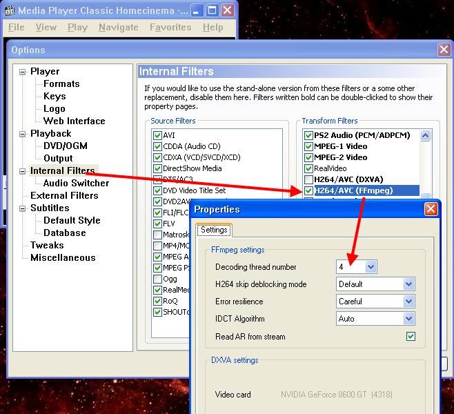

As noted before ffdshow's h.264 decoder is single threaded. You need a multithreaded h.264 decoder to play your files smoothly. Try CoreAVC Pro (not the standard version).
The smooth scaling is part of the graphics hardware. It shouldn't slow things down. All modern cards use at least bilinear or bicubic scaling. Which renderer module are you using in MPCHC? Oh, be sure you have multithreading enbled in its h.264 decoder (ffmpeg).
By the way, the #threads setting is also used by the Divx/Xvid decoder so it will help there too.
