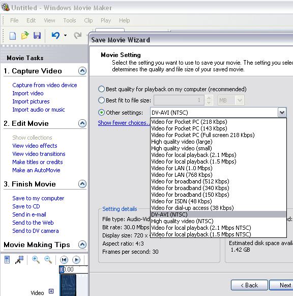

    You can do it in Windows Movie Maker. Export as "Other" "DV-AVI". Then Elements can read that.

    Hi Filmboss80 and EdDV,
    Thanks for your help, I have tried to use WMM but couldn't see "Export" in any of the drop down menu's or Movie tasks list, I also tried to download the VirtualDubMod and Cedocida DV Codec , once again I had a problem opening up the clip, I keep getting an error message "Couldn't locate decompressor for format XVID"
    I can view the clip in WMM after I download the file using Ulead photo explorer.
    I really am lost with this problem..

  13. Member edDV's Avatar
    Mar 2004
    Northern California, USA
    "Save to my computer"
    http://www.kiva.org/about
    Sep 2008
    Australia
    Thanks edDV, Thats the fix.. Thanks for your help, my vid is looking great now, i'm working on a Hang Gliding dvd and needed the footage from my small camera that i take with me.. I'll post it on Vimeo when it's done, check out http://www.vimeo.com/user801943/videos
