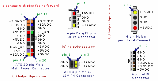

You can probably pull it out of there and jumper pin 14 to pin 15 and it should switch on. If not, replace as mentioned. If it does work, check to front panel switch and where it's hooked to the motherboard. If it is a dead PS, keep your fingers crossed that it didn't take anything with it.
