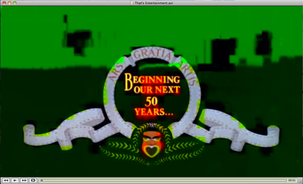

    I tried cutting the intro to this movie (avi file) and I'm getting this strange green stuff that lasts for about 5 seconds or so and goes back to normal. Does anyone know how I can avoid this? The only thing I did was follow the instructions to cut (marking the A & B areas, cutting, then saving) so I'm not sure why this is happening. Please help?!
Name:	Screen shot 2010-04-02 at 1.47.22 PM.png
