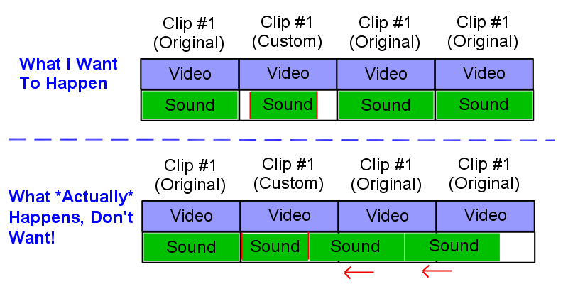

Basically, I have finished the video clips, they are all ready to go, identical Codecs present in each and after some tweaking, all the same Audio as well (Bluddy sampling rates were off on some ~_~). For my own video clips I created, I either stuck my own music in them, or left them without Audio (which was later fixed with 1 second blank audio files; VirtualDub wanted a matching number of Streams for all files).
BUT... but... when exporting all the Files coupled together, Direct Streaming both Video and Audio into one full length Video... the Audio is out of synch eventually. I would imagine, it's because my own Video's do NOT have an audio stream matching the length of the Video. It's coupling the video fine, but it's also stacking the Audio from each video clip RIGHT next to each other, thus: Everytime a Custom Video Clip I made comes up, the Audio desynchronises, and just gets worse as my own Custom Video's pop-up in the Video as a whole.
There we go, an image attached to better show what I believe is happening. I'm seeking a solution to obtain the top result in the image: I do not want VirtualDub to delete the gaps between the Audio between each AVI File (The bottom result).

Your guess on the audio sync problem sounds correct. When you edit the audio, you could add silence with a audio editor like Audacity to pad it out to the video length. Not so much work if you need to edit the audio anyway. Audacity will also let you taper the existing audio in and out so the transition to silence isn't so abrupt.
This is indeed what I have done, except I use GoldWave :P Respect to Audacity though, it's also an awesome Sound Editor. Opening my video files in VirtualDub and scrolling to the last frame, it indicated the precise Time Code required the audio had to be (Which was easily setup by manually setting the Markers, thankfuly).Originally Posted by redwudz
