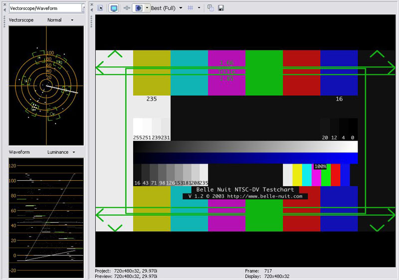

    A good test pattern to use for monitor brightness, contrast and gamma setting is the Belle Nuit DV test chart.
    http://www.belle-nuit.com/testchart.html
    Put it on your timeline and check your monitor path.

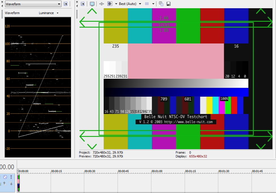

  11. Be sure you convert those RGB charts to DV correctly. Here's a small DV AVI file with a correct conversion:
    https://forum.videohelp.com/topic346864.html#1820664

    Jagabo's file worked fine with a simple import to the DV project timeline.
