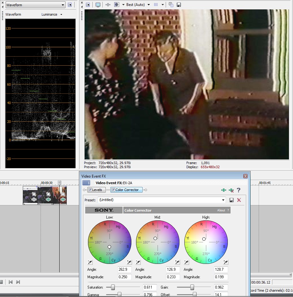

    Hello everyone. I'm new here and fairly new to video editing. This question is in regards to restoration. I have a VCR tape my aunt had made some years back where a place transferred a bunch of old 8mm tapes they found going through my grandfather's stuff after he passed. (Some of it was still undeveloped I think!)
    I just moved down here with my parents and in watching the tape I think it has even deteriorated further . So, I immediately imported the tape to a .mpg using a dazzle pro. I got pretty decent results, all things considered. I played with Premiere CS3 (v3.0), Cyberlink PowerDirector v7, and Sony Vegas Pro v8. I've been trying to use Vegas and have been playing with the FX's, including an "Auto Level FX" I downloaded which works pretty well.
    Now to the real heart of my question. Is there anything else I should try that would be good for a person new to restoration? I know programs like Picasa have a "I'm feeling lucky" option which does an amazing, automatic[ job at enhancing photos. Is there anything along those lines for video? Because each segment varies in quality and characteristics, I've "trimmed" the 1 hour video into about 200 segments which I'm trying to refine individually.
    Any help or advice would really be appreciated! Thanks.
    NOTE: The footage varies greatly in quality, but the following are two examples of some of what I'm working with... just screenshots from the Vegas preview window:
    [/img]

    If you can post a couple of minutes of footage it would be better.
    Some of this is probably best addressed through hardware during capture - TBC and/or Proc Amp.
    Failing or even post that, virtualdub or better yet, avisynth would be the best application to address any remaining issues. Vegas doesn't have great filters for restoration of these types of issues. It's filters are more aimed adjusting good quality footage for colour consistency etc.

    Prelim look shows serious levels, gamma and color balance issues.
    This will be difficult from VHS source due to narrow chroma bandwidth.
    The wiggly vertical lines can be helped with a time base corrector (TBC).
    Can the 8mm films be retransfered? Do you have a budget?
