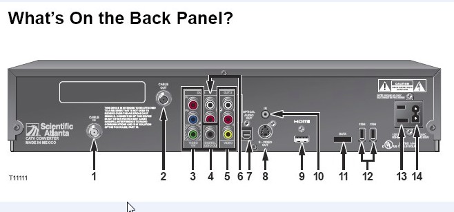

    I don't know about the Scientific Atlanta 8300 digital cable box but the 8300HD box does have a separate "VCR Record" function with separate composite/audio outputs to allow dubbing from the disk while watching another program.
    8300HD (#5 connectors for VCR out)
    This function gets set in the record/play menus.
    ClearQAM tuning is a function available on some DVD recorder tuners allowing direct tuning of certain digital channels (mostly locals) directly from the cable. Many digital TV sets can tune ClearQAm directly off cable as well (without using cable box).

    I just found this out today! I had asked my sister if I could borrow her DVD-Rec and as it turns out she bought one for me the next day. I have been trying to figure out my best options and all the exact connections needed for my particular setup when she surprised me with that. My DVR is filling up fast and I need to get some programs off that I want to keep. I've been recording the AL playoffs (GO RAYS!) and need to copy the games from my DVR to DVD. That's when my sister decided to get me an "early" Christmas present.
    The DVD recorder in question is a Sony RDR GX257. Not all the connections from the DVD-Rec match up exactly with all my other audio/video components but I can make do. For example: DVD-Rec has component video outs and my TV only has S-video; DVD-Rec also has 1 coaxial digital audio out (as does the SA 8300) and my receiver only has one each coaxial and optical digital audio inputs. this is how my connections are:
    Digital cable DVR:
    to T.V. via ant/cable (coaxial) with T.V. set to channel 4 (only output options from cable box are chs. 3 or 4).
    to DVD-Rec via composite aud/vid cables (DVD-Rec doesn't have S-video input)
    DVD-Rec:
    video output composite aud/vid cables to input ch. 2 on T.V.
    Digital coaxial audio to surround receiver
    I tried recording my baseball game from DVR to DVD-Rec from the "copy to VCR" option on the DVR. If I switched my T.V. from ch. 4 (the main connection from the DVR) to input ch. 2, (out from the DVD-Rec) input ch. 2 showed the video that was being recorded and ch. 4 showed the the cable menu! This was how I figured I could watch one show while recording something else! Everything I searched online said this couldn't be done.
    However, while enjoying my new found success, I switched backed to input 2 on the t.v. to see that the recording stopped due to, you guessed it, copy protected!!!!! AGH!@#@#@!@! Really!? TBS copy protects baseball games! Tell me this can't be true. There's got to be some way around this without having to break out the VCR and have my wife kill me! I told her if we got the DVR we wouldn't need the VCR to record t'v shows anymore! HELP!!!!
