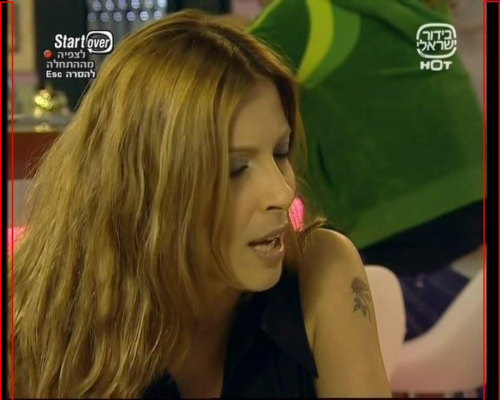

I've noticed that when I capture from some TV channels, I don't get a picture on full screen, I mean-there are black zones on the sides, as I marked here in red. when I watch tv live these black areas don't appear, only in records. do you know what causes it? thanks.

What you see in that sample is exactly what's broadcast. You don't see the black bars on TV because the TV overscans the picture (about 3 percent of the frame is not visible on all four sides).
I mean-I don't see those black bars also when I watch tv via the capture card. do you know why?
The player is simulating overscan and cutting off the edges of the frame. Find a source where the picture is static for a long time (channel guide, test pattern) and has recognizable objects near the edge.

No. Overscan is a property of the TV. The TV overscans everything. I recommend using a static image because it's hard to see how much the TV overscans with normal video where everything is changing all the time.Originally Posted by Yonidan
