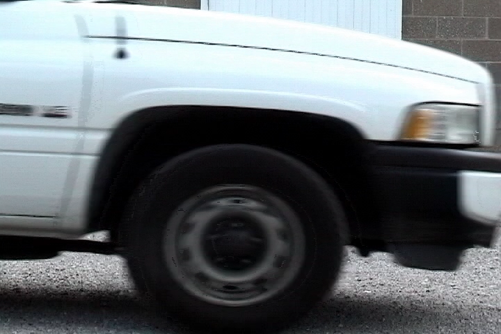

Here is one comparison of several deinterlacing filters:
https://forum.videohelp.com/topic354397-30.html#1877202
Here is the same frame from Smart Deinterlace in VirtualDub:
Here is the frame from MCBob():
This is only one frame of one video so don't make any final judgements on the quality of each. But it should give you a starting point. Keep in mind that TempGauss_beta1() and MCBob() are very slow, around 1/50th the speed of the others. -
they are both look good, tho I prefer the first one, of the Smart Deinterlace in VirtualDub. I don't get the same result with the Smart Deinterlace...why?

What exactly are you unhappy with? And why did you like Smart Deinterlace better than MCBob in the images I posted earlier? Notice how the line between the fender and hood of the card is much smoother with MCBob. -
Exactly. Also notice the horizontal artifacts near the bottom and side of the door, and the headlight. MCBob did much better for that sample IMO, at least in that frameOriginally Posted by jagabo

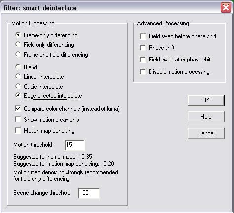

the smart deinterlace with Edge directed interpolate yielded good results of motion, but the picture was filthy.
maybe there are more settings to be changed? I attached a pitcure of my smart deinterlace settings.
just check it..if everything is ok there.
secondly, I'd like to try Avisynth and mcbob, but you say that the process is very slow.
I want to record a tv series, every chapter of that series lasts about 45 mins.
how much time will it take to de-interlace such video with mcbob?
Other than edge-directed interpolote I used the default settings in Smart Deinterlace -- the same settings you have. Are you saying the sample I uploaded was filthy?
