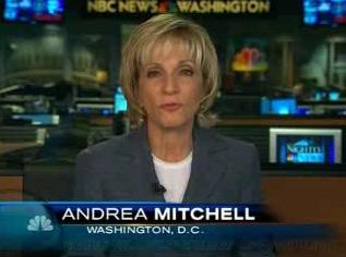

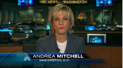

Graphics for TV news are placed for overscan rules in 16:9 or 4:3 like this.
16:9
4:3
Overscan will take 5-10% off the edges.Recommends: Kiva.org - Loans that change lives.
