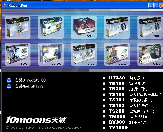

  4. I would like to confirm the above directions. I copied them exactly as in the screenshot (see screenshot 1) and followed the directions for merging. However, when I insert a software disk into the cd drive (after rebooting), the software menu still appears (see screenshot 2). I was under the impression that after modifying the registry, the software menu will NOT appear. I don't think the above trick (to disable autorun) works on my xp computer.
  5. I found the following DOES work to disable autorun. At least, when the above software disk is inserted, nothing happens (no menu appears). However I still wonder if a nasty virus might secretly re-enable the autorun.
