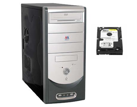

  12. You need to clarify what you mean by "hard drive". Many people refer to the main computer case and everything inside it (as opposed to the monitor) as the hard drive. In actuality, the hard drive is only one component inside the case.
    Case (left) and hard drive, approximately to scale:
    The case typically contains at least two fans. One in the power supply and one on the CPU's heat sink. There are often more fans to blow air into and out of the case. The case and the heat sink often get full of dust.
    Constant Gardener was talking about opening up the case and blowing out any dust that has accumulated inside.
    The CPU fan is sometimes controlled by a temperature sensor so it spins faster when the CPU heats up (like when encoding video). The other fans are sometimes hooked up to heat sensors too.

    Well,I was referring the harddrive as many ppl thought it was - the main computer case and everything inside it.I have never opened the case. How to detect that the hard drive is overheating before it gets totally burned out??
