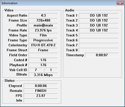

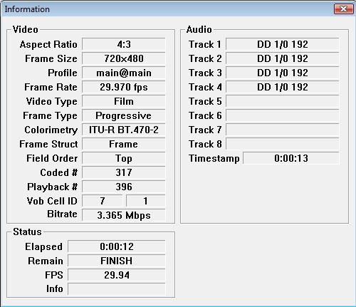

	I realized this before you posted and I Forced Film (under Video->Field Operation), but what do you mean "then use Honor Pulldown Flags and IVTC them?" Under the Video->Field Operation, I can only chose Forced Film OR Honor Pulldown Flags..Originally Posted by manono
 also, what setting should I use under Video-iDCT Algorithm in DGIndex?
	If, when running the Preview, it shows as Progressive and Film, then set it for Force Film and make yourself a 23.976fps D2V Project File. If it shows as NTSC and Interlaced, then further examination is called for to determine if it's hard telecined film (in which case you make the D2V using Honor Pulldown Flags and IVTC in the script, making it 23.976fps), or if it's truly interlaced (shot on video) in which case you make the D2V using Honor Pulldown Flags and deinterlace in the script, keeping it at 29.97fps. I couldn't remember if the cartoons were film or hard telecine, but in any event the true framerate is 23.976fps.
	Thanks for the response. Those pics show the information while previewing. I'm using the Forced Film option, but the XviD is still grainy.Originally Posted by manono
