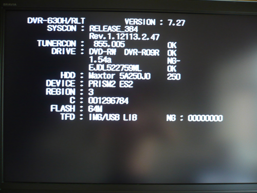

  5. Hi bros, I try a fake CPRM ID from faq guide: 001296784 and it works now, even I can record and playback on my new HDD.
    But everytime I will have 'wrong HDD info' err msg during power on. Looks I got to UG my firmware but I need some advise before doing stupid things again
    Any suggestion?
    PS. I attach my ver info find from service remote page, hope some expert can help.

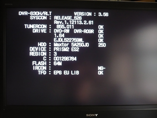

  6. Looks I did stupid thing again... I download the 630H firmware and update.
    After that I dont have any HDD err msg anymore, but I can't gain control by my remote control. Once it enter 'home menu' I can't quit it, I can control the up/down but just can't press enter nor quit (I have to do power reset than...)
    From service page it seems err on IRCON, it show NG-... service manual ask me to download firmware but where can I find the suitable one?
    Mind DVR is 630-HS while official pioneer website only got 630H...
  7. You did use a totally wrong firmware for your DVR, you used the firmware that is from Pioneer Europe.
    Check your PM!

  10. thanks bros, after consult with Hkan I fix my machine. (I was upgrade with a wrong firmware but lucky Hkan got a correct one.)
    Now I am enjoying my new 250GB HDD
