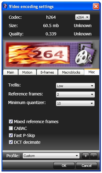

 Click on the MISC tab. Change it so that it looks like this:
 Please note that the only change you are really making here is the setting for REFERENCE FRAMES. You are changing it to "2" instead of the default of "6"
 Now click OK and you are ready to encode. Make no other changes (although sometimes you may have to check the resolution settings under VIDEO).
