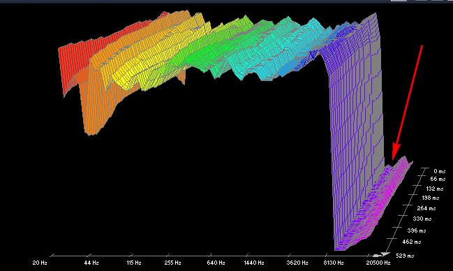

Here's your noise clip. That Niagara Falls drop at 8000Hz says the source was probably an Mp3 or Mp2 compressed file. Between 4200Hz and 8100Hz you see an increase in volume, which is probably where a lot of the hiss comes from. Anything above 8130Hz is high frequency crackle. So with an aggressive EQ, you can cut between 7600 and 20000. Anything below 80hz on the low end of the spectrum is probably rumble and can be cut as well. The tricky bit is reducing the frequencies between 4200 and 8100Hz without affecting the overall sound too much. Experimentation will be required in that area.
Here's an example of EQ run against your noise file. You'll hear the before and after every 1 second.
