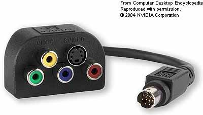

My similar Compaq uses one of these.

Not sure if you are responding to my post, but VGA to component cables are not common. Just a few video cards have a connector with more than one output. Some ATI cards can output component with a proprietary adapter. But generally, VGA is just VGA.
With a laptop, check with the company that made it. They should be able to tell you the capabilities of the internal video card.
