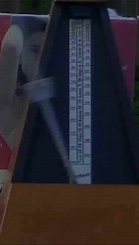

correct field order was used (top). About resizing vertically I am not exaclty sure what you mean by this. I used the Crop/resize tool in vegas and using the arrow on the box shrunk the images down to a suitable size so that they both would fit on the screen (while the whole picture size itself was still 720x480)
below is a pic where you can see what I am talking about. It happens for both pictures on the screen
Yes, you resized the frames vertically. By doing so you have blurred and mixed the two fields together. You need to use special interlace aware resizing techniques when changing the vertical size of the image.
An interlace frame contains two half pictures (fields). One half picture is in all the even numbered scanlines and one is in all the odd numbered scanlines. Before resizing these two half pictures have to separated. After resizing they have to be woven back together.

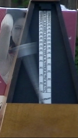

For example, here a crop from an interlaced frame (480 lines tall but only 272 lines wide):
It contains two half pictures:
Here are the two half images with all the black lines removed, set side by side:
reduced in size by half:
and woven back together (240 lines tall, 136 lines wide):
This isn't the best way of resizing interlaced video but it should give you an idea of what must be done.
Then when positioning the downsized image into the larger frame you must be sure that the vertical position leaves the right field on the right scanlines in the larger image. Ie, the even field must remain on the even numbered scanlines of the new image.
I don't use Vegas but surely it must have some facility for handling interlaced sources like this. -
