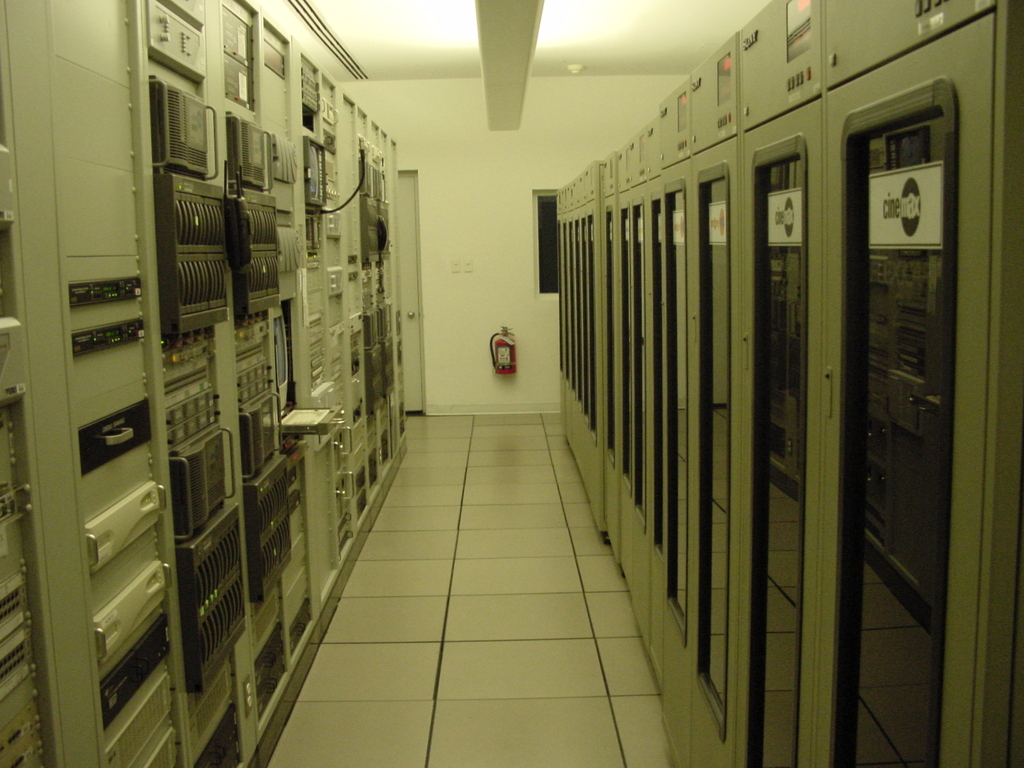

    Here is a picture of the HBO uplink facility in 2003 when all movies were played from tape. Since then I'm guessing it has all gone to hard disk playout servers but ingest is probably still from HDCAM and DigiBeta tape.
    Each of the racks on the right contain robotic tape players for one cable channel. There are two redundant playback racks for each uplink to provide backup. The hard drive playout servers on the left handle the breaks and promos.
