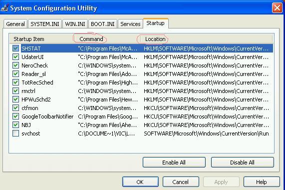

Since the mysterious files are added only on bootup, I was thinking of checking the startup utility, Start >Run>
type msconfig>OK>Startup (see screenshot) and see if there is something there isn't supposed to be there and:
1) stop the process
2) see if I could trace the offending file and delete it
I'm not sure how to do step 2. Under "Command" heading there seems to list the location of the files, like C:\...
Should I just delete the file (that shouldn't be there)? But what about "Location" heading, like HKLM\...?
I don't know what that is. Is that part of the registry? Should I also delete the offending entry in the registry?
For your information, I made a Ghost image of the c drive when the computer was exhibiting this problem. Then I restored the c drive from a known good image so the problem doesn't exist any more. If I want to analyze the problem, I would have to restore the c drive from the Ghost image that contains the virus. The below screenshot was taken from the restored c drive without the virus. Unfortunately, I did not look at the startup utility when the virus was on the computer, so I can't compare.
I haven't changed the existing McAfee on this computer. It is not my computer, so I don't want to make any major changes because there is nobody here who can help me if I screw it up.
