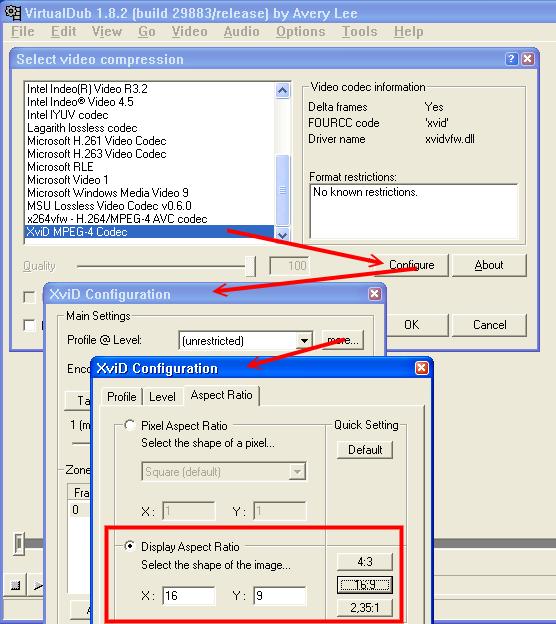

You can also leave the resolution as it is and use the MPEG4 DAR setting to specify the aspect ratio of the final displayed picture (4:3 or 16:9). Not all players will respect the DAR setting though.
