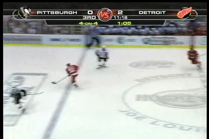

As you can see, interlacing has a huge effect on this type of footage, because of the fast motion and high contrast (dark sticks / players on white ice). Here is frame 500 of the above video:
I am trying to use AVISynth, MSU Deinterlacer filter, and Virtualdub to deinterlace the above video, and this is my sample script:

This is from the yadif script, the same frame 500. I didn't crop the edges, but you can tweak/edit it to your tastes
MSU_FieldShiftFixer() isn't a deinterlacer. It's for recombining fields of a progressive PAL source where the fields are paired out of phase.
You need a real deinterlacer like Yadif, TDeint, LeakKernelDeint, TempGaussMC_beta1, etc. -
