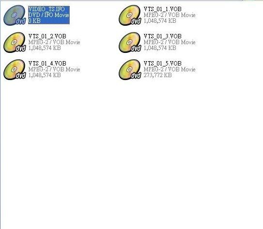

    I follow this guide to author the new DVD, but after muxing it , the VIDEO_TS.IFO file
    keeps 0KB, is there any ways to solve this?

    Here is the log file's warning msg, is this related to the problem?
    Video decoder buffer underflowed 2 times.
    Check c:\muxman.log for details.
    Resulting DVD will probably not play smoothly.

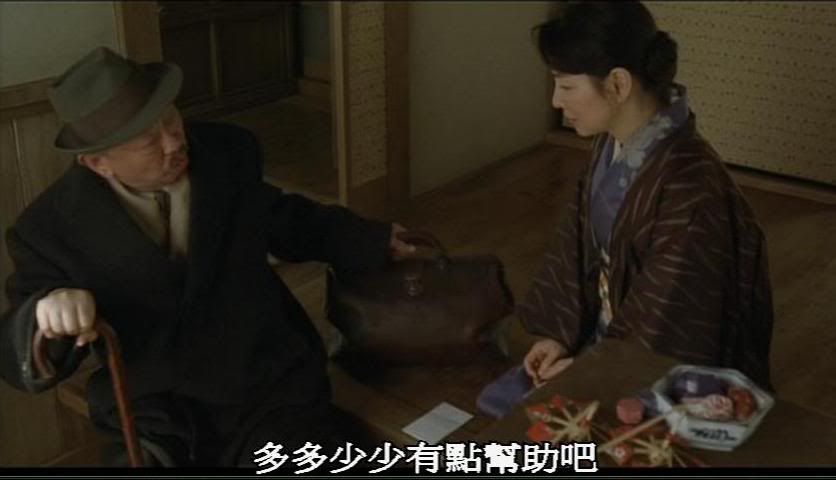

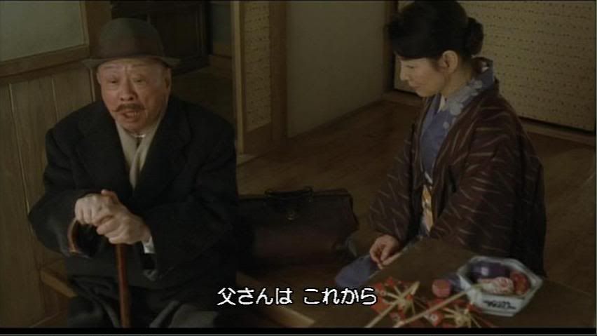

    Here are the 3 pics,1 and 2 are the defauly subs, 3 is my sub
    this is the result after using ifoedit to author the new DVD(with no menus), they
    show normally. But after using vobblanker, the subs returns 2.
    I have checked my subs with subtitlecreator, no problems were
    found. Even I give up Jap subs, with my trad chinese subs as first
    subs, after using vobblanker, my subs still cannot be shown. (vobblanker
    seems holds the original subs(ie JAP and ENG) without considering my subs.
    I have tried many times and still can;t find the cause problems
    1(Default)
    2(Default)
    3 (My sub)

    If you have 3 subs after authoring with IFOEdit, then you also have 3 subs after VobBlanker. Don't believe me? Then demux the movie using PGCDemux - demux the final DVD after the VobBlanker step - and I'll bet you'll get 3 SUP files out of it. You must not be "turning them on" correctly. After "turning them on" in PGCEdit or IFOEdit or however you do it, open the DVD in PGCEdit, double-click the movie and check if you have 3 sets of subtitles. VobBlanker isn't muxing the subs. You already did that with IFOEdit or Muxman or whatever you used to author. VobBlanker is just integrating the newly authored DVD back into the original DVD.
    Also, do as I suggested and open the final DVD in DVDSubEdit and see if you have 3 subtitles. If it does show 3 sets of subs but you can't play your Chinese subs, then they're too low to be seen, or transparent, or some other reason they're not being seen. As I said, DVDSubEdit has the fix for that.

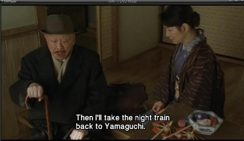

    Yes. You are right. I finally solve the problem and make the 3 subtitles shown correctly~ Thanks man
    but.......another big problem occurs... when I burn the disc and put it into the player to test, something interesting
    happens, the default2 subtitles have no problems, showing nice and properly, but when I select my subs to see,
    the DVD player hangs!, the LED display of the DVD playeris abnormal, and the movie just stops playing! I have tested the final output by kmplayer with no problems, 3 subs can be displayed neatly and properly,why does such happens? Does it related to the player or my authoring process?
