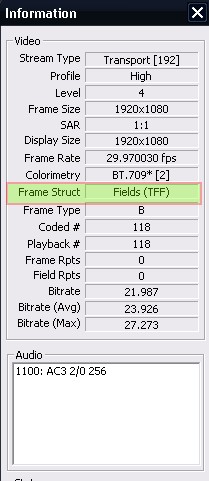

    Open up the file in DGAVCIndex and choose File--->Preview. It'll tell you about the characteristics of the file.
    Check out this article http://www.elurauser.com/articles/canon_progressive_modes.jsp
    Here's your file. 30p inside 60i, hence it's detected as field based video

    Thanks Soopafresh. I'm not sure what to do now. Is there a way to make this a true 30p AVCHD mts file, so I can import it into Video Studio 11.5+? I've got a workflow down using that program with the mts files.
    If not, do you know of a way to de-interlace this mess so I can use VFAPI or something. I saw your other thread, but that doesn't have to do with this kind of deinterlacing I don't think. UGH - Why couldn't Canon have made this simple. I didn't know what I was getting into... and I thought I'd been through all this with learning how to edit my first generation panasonic AVCHD files.

    Yes, output should be progressive.
    Yes, you can frameserver to vdubmod, or you can save frames in bmp format in DGavcindex
