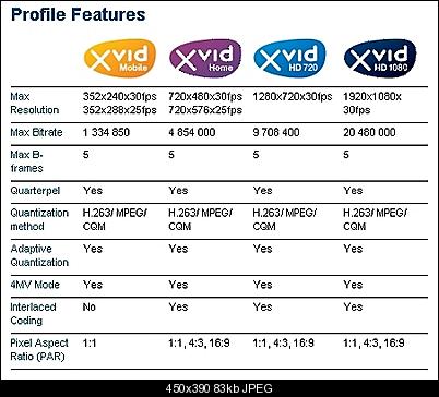

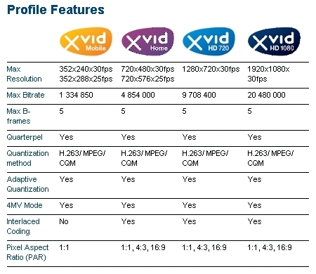

  9. XViD encoding for DiVX compatible DVD and BD players.
    AVI files encoded with Global Motion Compensation, Qpel, Packed Bit-Stream, MPEG quantization, multiple B-frames (More than 2) or files that exceed the VBV limitations may not play back properly on DivX Certified hardware players.
    While helping someone here and searching on internet, I came across following settings of XViD for DiVX player compatible output.
    There is also a guide on Doom9 which contradicts with quarter pixel, which should be turned-off.

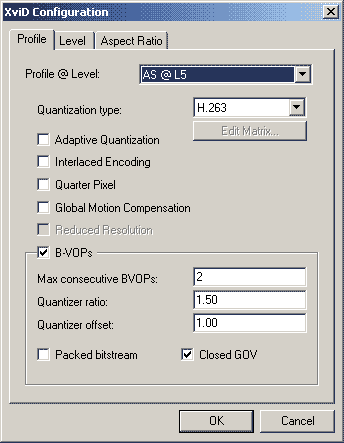

    From AVI recomp - tool mentioned above.
    For best standalone DVD players compatibility.
    * no QPEL
    * no GMC
    * max. cons. BVOPs = 1
    * no packed bit-stream. packed bit-stream may choke old dvd players. Uncheck packed bit-stream.
    * preferred FOURCC settings DIVX or DX50.

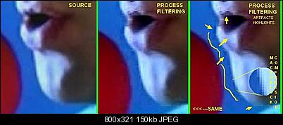

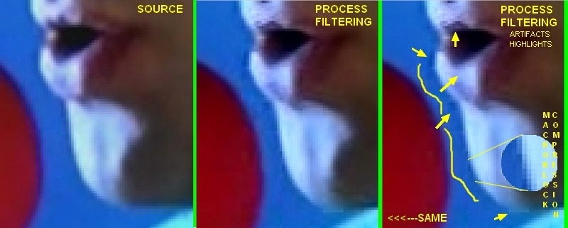

    Why should I deinterlace?
    Deinterlacing is useful for viewing interlaced content on a progressive display such as PC Monitor, LCD or plasma. There are tons of methods to deinterlace video, each one has it's own different problems or artifacts. Some methods are better than other methods, but none is perfect. Deinterlacing removes fine-minute details as well. You should try different methods according to nature of source video, and select one method which produces the best results for that particular source.
    Left Motion Blurred and Original Source on right. (Courtesy : Wikipedia)
    If your final encode looks like right-half i.e. pretty close to your source, you are OK. But, if your final encode looks like left-half with lots of fine details missing, you have to re-consider your encoding process.
    Know it before encode, Avoid re-encode and Re->Re->encode. Try to preserve maximum details as source.
    If your source is High Quality BD or DVD, it requires only proper de-interlacing, no more additional filters.
    For example : Over sharpening may lead to over sharpening halo or cartoon effects. Adding additional grain may result in loss of over all picture quality sharpness. Following pic shows artifacts generated by applying various professional grade (???) pre-processing filters in addition to deinterlacing. Even deinterlacing resulted in loosing some fine - minute details and original acute sharpness from high quality source. Download following image and have fun with zoom-in and zoom-out.
    I do not care whatever it is - color-banding, halo, speckles, edges, pixelates, maze, ringing, aliasing, noise, posterization, macro-blocking, or stiches. You can name it the way you like, I would say patches or Dirty Pixel in J F Blinn´s terms to be more precise. But it is there and it is NOT wanted as well. This is an ocean deep topic and endless journey to travel. The rest is upto you.
    In media, a golden rule is: one should "do the least harm". This also translates to "leave well enough alone, unless it's necessary".

    Which XViD to use?
    Recommending something may lead to ad-wares/bloat-wares.
    Over other video enthusiastic forums JAWOR's and Alexin's are recommended. or you can try Chris CLI. Try at your own risk, Scan first!
    You can select an appropriate profile from above.

    Any sample, please?
    I have came across many beautifully encoded samples of XViD. The one below not only went-through but touched the heart with a message of "Peace & Love".
    Following the most beautiful message (sample) is taken from the motion picture "The book of Eli", and it would be pleasant to cite here only for educational purpose, or to spread the words of "Peace & Love".XViD/DiVx offers many ease & peace over others. I posted mkv on purpose. You can open "Spread The words.Sample.mkv" in any editor of your choice which can offers you a feature called "stream copy", and you can get "Spread The words.Sample.avi" without any further re-encoding.
