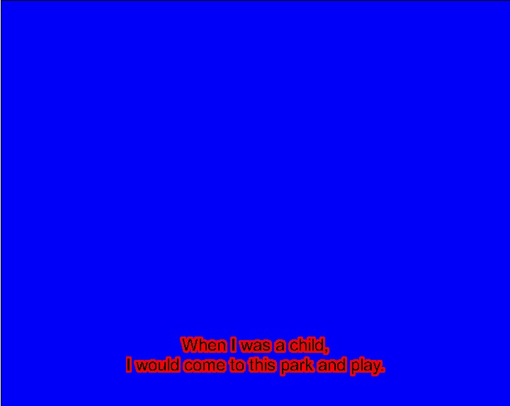

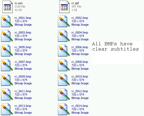

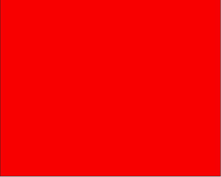

  10. I have confirmed that Subrip is faulty (and not Fair Use Wizard). I opened the sub/idx file (from Fair Use Wizard) in
    SubResync (comes included in the VobSub package), and all the BMPs extracted perfectly with clear subtitles.(See screeshot 1). Subrip will only extract BMPs reliably when extracting directly from the DVD. Subrip would not extract BMPs reliably (10% subtitles skipped, ie an empty red BMP with no subtitle) from a standalone sub/idx file. I confirmed this fault in 2 ways:
    1) Used Subrip to extract BMPs from sub/idx file from Fair Use Wizard. 10% of subtitles skipped.
    2) Used Subrip to extract BMPs from sub/idx file from VSRip. Same 10% of subtitles skipped.

    Screenshot 2: BMP (from sub/idx from Fair Use Wizard) gotten by SubResync (comes included in the VobSub package)
    Screenshot 3: Same BMP gotten by Subrip - subtitle not visible, about 10% of BMPs had this problem

  12. Success (thank you very much). I can take a standalone sub/idx file and increase the subtitle size.
    Using SubResync (comes included in the VobSub package) on the sub/idx file to get the BMPs/son files, then batch increase the font of the BMPs with Irfanview, then use SON2VSub on the increased size BMPs/son to convert back to idx/sub and use this new sub/idx in place of the original sub/idx. The only thing I needed to do is change the default number of 480 to 576 (See screenshot 1) for this pal movie.

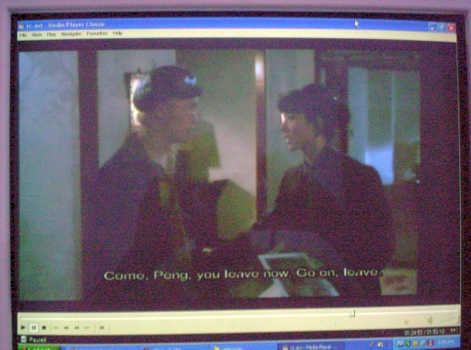

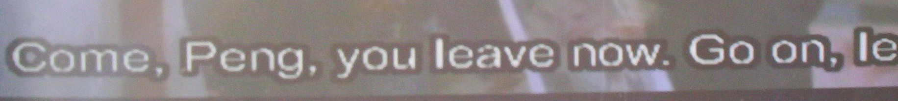

    I noticed one strange thing however. Enlarging subtitle size by using the Media Player Classic trick (as you explained above) gives clearer subtitles (look at letter "e") than enlarging the subtitle size directly inside the BMPs. Screenshot 2 shows subtitles enlarged by the Media Player Classic trick and screenshot 3 shows subtitles enlarged by increasing the size of the BMPs. It is a tradeoff because the method used in screenshot 3 will play on any computer, while method used in screenshot 2 will only work in Media Player Classic. However, I think Media Player Classic can be installed on most public computers because it is "green" software.
