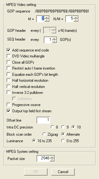

As to CCE and the frame rate issue:
CCE Basic doesn't support Film->NTSC pulldown at all. I had the "DVD" option selected during early encodes, which made CCE change the frame rate to be DVD-compliant. It did that by inserting frames.
By changing to the "MPEG-2" option, I got it to do a true 23.976 encode, though the MPEG frames were still flagged as interlaced.
I am able to use PULLDOWN.EXE to fix the m2v file now that I know the magic "-prog_frames p" option (which really should be the default). DVD-lab can also apply the pulldown flags but it left the frames flagged as interlaced.

According to the Doom9 guide to Basic CCE, there's a check box (along with a pic showing exactly where) to have it flagged as progressive:
http://www.doom9.org/mpg/ccebasic27.htmCheck Progressive source if you're dealing with progressive content, if your content is interlaced, make sure this is not checked.
I disagree, since pretty much by definition any candidate for pulldown has to be progressive to begin with. It does seem strange, though, that CCE Basic doesn't have the ability to apply pulldown and screws up a 23.976fps encode by adding duplicate frames if you encode it for 29.97fps. And you must know this already, but if planning on applying pulldown the N/M in that pic should be changed to 4.I am able to use PULLDOWN.EXE to fix the m2v file now that I know the magic "-prog_frames p" option (which really should be the default). -

That CCE check box just tells the encoder to treat the source frames as progressive vs interlaced. I have it checked, along with the Zigzag scan order. It clearly has nothing to do with the output.
CCE SP fully supports film encoding, but Basic doesn't. I found that it always marks the output frames as interlaced even when doing a progressive encode at 23.976. It simply doesn't support pulldown. It's pretty lousy that it duplicated frames with the "DVD" option, but it did create a DVD compliant bitstream!

Why do you say that when it's not true? How are you determining it's not setting the progressive flag? Just for you I downloaded the CCE Basic Trial, did an encode with that "Progressive Source" box checked. The resulting MPV shows as progressive in every app with which I check it:Originally Posted by LoopinFool
I guess that's how they get people to pay $2000 for SP2.Originally Posted by manono

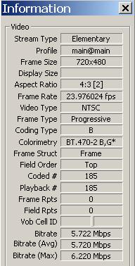

I've been using GSpot and it clearly shows interlaced BFF on my CCE encodes at 23.976 with the progressive source box checked. I checked one with ReStream and it showed the same. I believe I'm using the latest release of CCE (version 2.70.01.16), but I'll have to check.Originally Posted by manono
Thanks for checking that out. I must be setting something different than you did. Of course, the file still needs pulldown processing and all the flags can be re-set to the right values then.
Perhaps CCE is relying on the i/p status coming from its input and saving the "correct" type based on that. The source is DV so is interlaced. I don't know how to fix it if that's why CCE thinks the source is interlaced.
What program did you use to examine the file? I like that display. It's compact and full of info.
*edit: Nevermind, I see it's the latest version of DGIndex.

Right, I forgot to check in GSpot, and if I had I would have mentioned that it's unreliable as far as CCE encodes go. That was an oversight on my part and I apologize. I did check using ReStream and it shows it as progressive. This is using the CCE Basic Trial 2.70.01.14 that puts the nasty logo in the video.
Yeah, but you don't have the choice when using DGPulldown. You don't need it either. I stopped using Pulldown.exe when DGPulldown became available, as DGPulldown allows you to do all kinds of "unconventional" pulldowns, perfectly suited for many of my sources.Of course, the file still needs pulldown processing and all the flags can be re-set to the right values then.
It's no longer interlaced after applying your IVTC. I just checked to see if encoding as BFF made a difference anywhere, and it didn't. I'm not quite sure why you're encoding as BFF, though, once it's IVTC'd to progressive 23.976fps.The source is DV so is interlaced. -
I only said that in the context that it appears CCE is flagging its MPEG output as interlaced (on my system). I was trying to figure out why it might think the source is interlaced after IVTC in AviSynth.Originally Posted by manono
I would think that checking the "progressive source" option in CCE would override everything else. It's possible I still have the BFF option checked, too (or TFF unchecked - don't remember which is in there).
I'll do some more checking this weekend to figure out why CCE is creating strange MPEG files for me. I do believe I have it properly doing progressive encodes at 23.976 and that it's just flagging its output wrong. I now have more tools with which to investigate. Maybe it was just GSpot getting it wrong.
I also plan to use DGPulldown instead of pulldown.exe. I trust it more and the pattern it creates matches what HCenc creates when viewed in ReStream.
