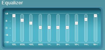

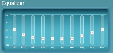

When using a V shaped equalizer setting be sure that the ends of the V do not go too much above the zero dB line. Ie, move the center of the V down, not the edges of the V up.
Do this:
not this:
The latter will cause distortion when there is strong bass in the source. -

Next, I set my equalizer at the recommended V shape. I didn't have them all the way up but I lowered them as shown.
