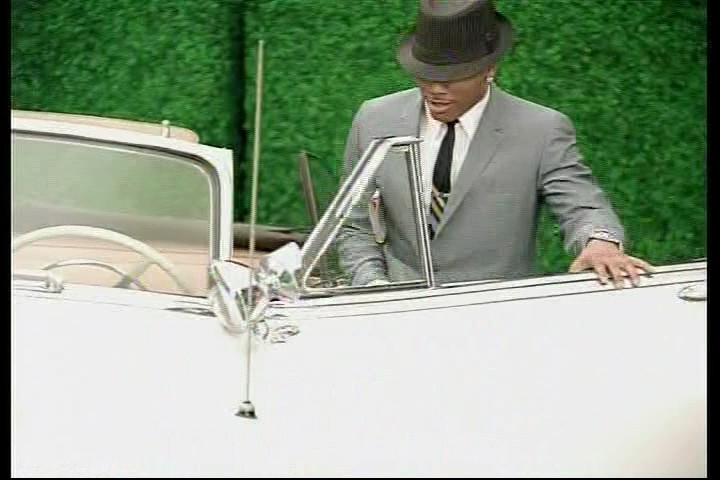

ashanti_-_good_%20good.mpg -
You could do this:Originally Posted by ziggy1971
src = MPEG2Source("ashanti_-_good_good.d2v").ConvertToYUY2(interlaced=true).As sumeTFF()
v1=Trim(src, 1,18).SeparateFields().SelectEvery(10, 0,1, 2,3, 4,5, 7,8).Weave()
v2=Trim(src, 19,73).SeparateFields().SelectEvery(10, 0,1, 2,3, 5,6, 8,9).Weave()
v3=Trim(src, 74,108).SeparateFields().SelectEvery(10, 1,2, 4,5, 6,7, 8,9).Weave()
v4=Trim(src, 109,224).SeparateFields().SelectEvery(10, 0,1, 3,4, 6,7, 8,9).Weave()
v5=Trim(src, 225,260).SeparateFields().SelectEvery(10, 0,1, 3,4, 6,7, 8,9).Weave()
v6=Trim(src, 261,286).SeparateFields().SelectEvery(10, 0,1, 2,3, 5,6, 8,9).Weave()
v7=Trim(src, 287,297).SeparateFields().SelectEvery(10, 1,2, 4,5, 6,7, 8,9).Weave()
return(v1+v2+v3+v4+v5+v6+v7) -

Mostly I was showing another option. I wouldn't bother doing this type of manual IVTC with a video like this. There are too many telecine pattern breaks. But watch the door closing:
TFM:
manual:
yes on every cut.
i'd not think it ever worth it.
i don't see what you're showing me.
i've got no aliasing.
got a bobber in there?
and in fact,
taking you're showing me frame 60,
with your posted script, frame 59 is still interlaced
tripp"I'll give you five dollars if you let me throw a rock at you" -
I didn't bother "fixing" frame 59 because a) It's not my video and I don't care, b) it contains orphaned fields, c) a single interlaced frame at a transition isn't critically important. I also skipped the first frame because it contains an orphaned field, and the last two frames because the sequence was short and I was only demonstrating the method.
I do manual IVTCs when there are only a few telecine breaks. It's far cleaner than any of the automated algorithms. TFM left several badly IVTC frames like the one I posted. I used the exact script you posted TFM().TDecimate(). -

heart alone
http://www.mediafire.com/?mm1dvmmnmmz
ashanti
http://www.mediafire.com/?woydxamimn0
done with tfm()
with 'alone' you can see some noticeable jerk in one zoom.
and with 'ashanti' you can see it's not plain 3:2 all through,
there's some crap too... not really worth note, but still indication
of music video uglies.
