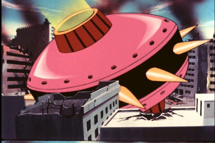

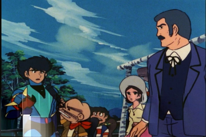

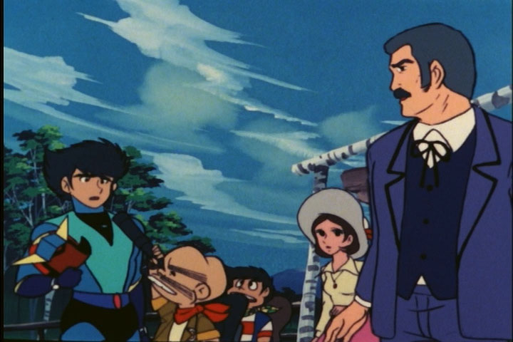

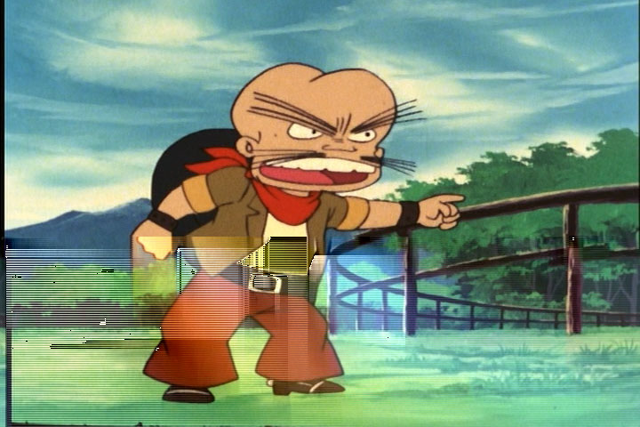

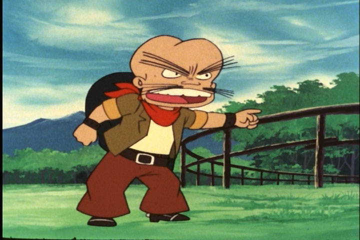

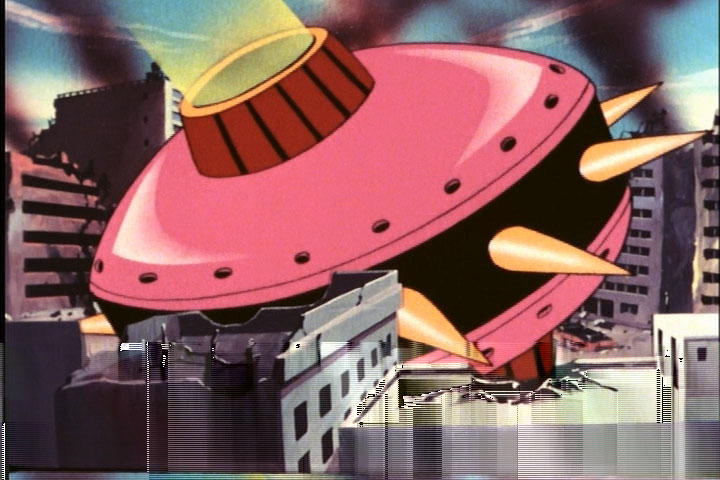

  20. OK, here we go. I think the problem is not the joining part.
    I just reviewed some of my finished AVI files which I had exported from Premiere and found flickering therein. I will attach examples.
    Again, these are files which used to be VOBs, were converted to Huffyuv AVI in VirtualDub, then they were used in Premiere for editing, and finally exported as Huffyuv AVI. These are 23.98 fps files originally and were kept that way to eventually be authored with the 2:3 pulldown.
    The exported files have this flickering in them. Please see attachments and let me know what you think.
  21. Flicker.
  22. Non-flicker.
  23. Flicker.
  24. Non-flicker.
  25. Flicker.
  26. Non-flicker.
