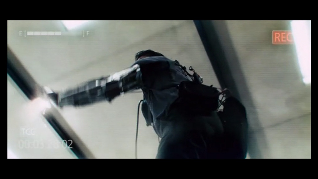

I've switched over to AVStoDVD (also free and HCenc ready). It's very easy to simply go to the Avisynth tab and add what ever borders you like and preview right from the app.
An example:
Original
Video = Video.AddBorders(0,44,0,44)
After changes. I just added 16 to each number (L,T,R,B)
Video = Video.AddBorders(16,60,16,60) -
If you reduce that picture to 720x576 the black borders at the sides are only 16 pixels each. That's not enough overscan compensation for most SD TVs.
