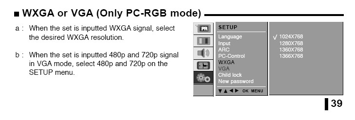

    In the television menu 'WXGA' 'VGA' are greyed out and cannot be selected?

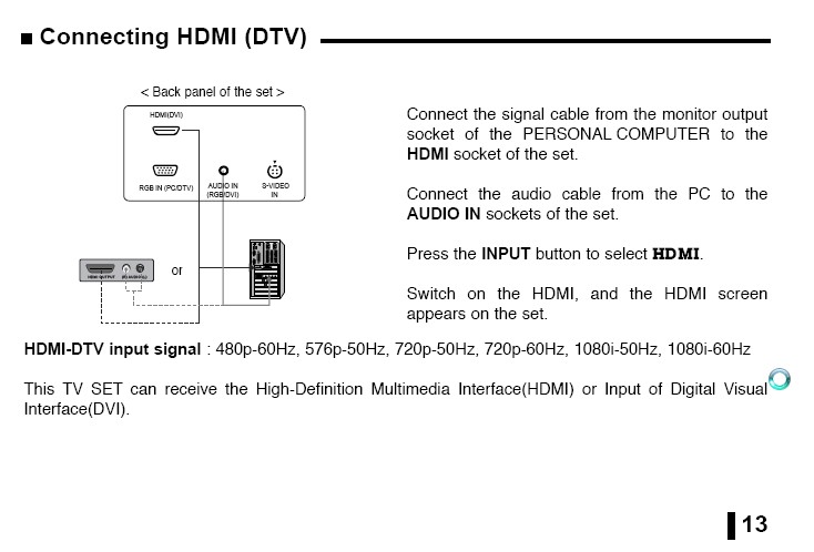

    From the online manual
    Connect the signal cable from the monitor output socket of the
    PERSONAL COMPUTER to the RGB IN socket of the set.
    Connect the audio cable from the PC to the AUDIO IN sockets
    of the set.
    Press the INPUT button to select PC-RGB.
    Switch on the PC, and the PC screen appears on the set.
    Do PC Auto on Menu to adjust the screen automatically.
    The set can be operated as the PC monitor.
    RGB-DTV input signal : 480p-60Hz, 576p-50Hz, 720p-50Hz,
    720p-60Hz, 1080i-50Hz, 1080i-60Hz, 1080p-50Hz, 1080p-60Hz.
    It does not seem to actually work as a standard VGA input
    Read my blog here.

  20. Member edDV's Avatar
    Mar 2004
    Northern California, USA
    That means you need to set the display card to either 1920x1080 or 1280x720.
    I don't know how you can do this without seeing the menus. Maybe it can be set to default on boot.

    You can try 1680x1050p but the manual seems to indicate only video resolutions are accepted over HDMI (e.g. 1920x1080i or 1280x720p)
    The PC port seems to allow only WXGA (1366x768, 1360x768,1280x768 or 1024x768).
    There is no mention of pixel by pixel 1680x1050 support but you can always experiment.

    Please stop referring to the manual, i have already looked over it, WXGA is greyed out in my TV's menu, I can't select it.
    So have you sent video resolutions in VGA or HDMI mode?
    The problem is probably with the NVidia card settings. The TV wants one of those listed video or WXGA resolutions active before it accepts the signal. The NVidia won't detect the TV unless the TV port is active during boot.
    You will probably need a second monitor to get this set up.
