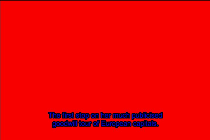

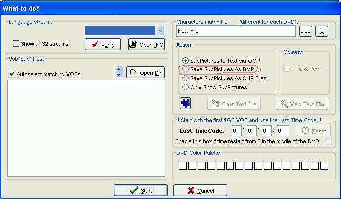

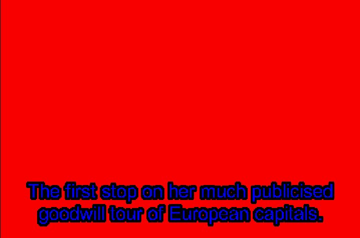

The result was I got about 1000 .bmp files that seem to correspond to all the subtitles. See screenshot 2 for an image of one of the .bmps. You can see that it is blue and not so clear. Now, what do I do with these 1000 or so .bmp images? I want to make them bigger. You said to use Irfanview batch processing. How do I do that? Then, how do I convert the .bmp to SST for Muxman?

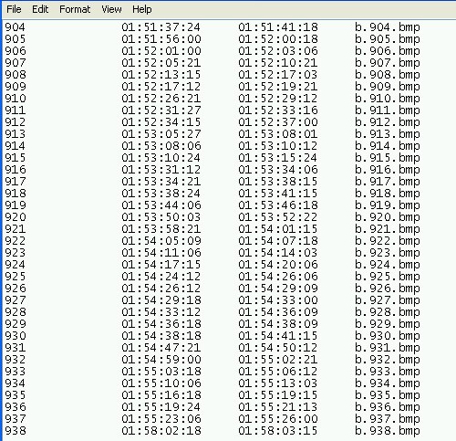

In addition to ticking the "Save Subpictures as BMP" box, also hit that blue jigsaw puzzle piece looking box just below and it'll give you a chance to save it as an SST file. That way you'll get the SST text file along with all the BMPs. Then you crop and resize the BMPs, replace them in the folder with the SST text file, and you're in business.The result was I got about 1000 .bmp files that seem to correspond to all the subtitles.
There's nothing wrong with those BMPs. That's how they're supposed to look. Make them 720x478 if for NTSC dialog subtitles. Also 4-bit color. -

Thanks for the info about ticking the other thing to get the SST file.

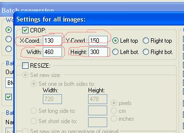

Thanks for the info. I'll let you know what happens. I'm not sure what I'm supposed to crop, or why it is necessary to crop. I'm not sure how to make the subtitles bigger in Irfanview, but if I can figure all this out, I am going to post the click by click recipe with screenshots that anyone can follow. I see from previous postings on this board, other people have wanted to increase subtitle size and presently is no simple recipe given to do this.

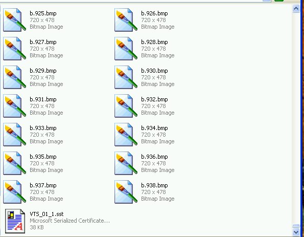

I managed to use Irfanview to crop and resize the BMPs. (See screenshot 1 and compare with above screenshot of original subtitle.) I saved all the larger BMPs (with same name as original) in a folder along with the sst in the same folder (see screenshot 2) . I used Pgcdemux and then Muxman and inputed the sst into Muxman (see screenshot 3) , but the result did not have any subtitles at all when played on Media Player Classic. Inputing the whole movie in DVDSubedit also did not have subtitles. Can you tell me what I did wrong? Is it OK to input sst (with BMPs in same folder) into Muxman? I know that Muxman normally just takes sup files. Is there a way to convert the sst/BMPs folder to sup? I could not do this with Subtitle Creator.

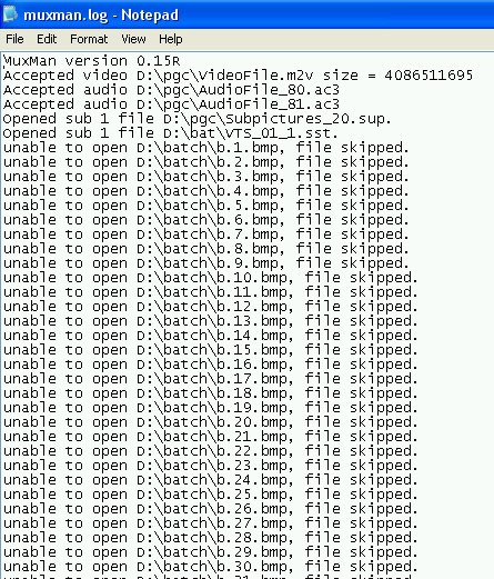

Not offhand, as you haven't supplied near enough information. I know it must be frustrating, though, to get so near to the end and then have it not work. The Muxman.log in the root of the C Drive might have the needed information.Can you tell me what I did wrong?
Yes, I do it probably 2-3 times a week.Is it OK to input sst (with BMPs in same folder) into Muxman?

If muxman didn't accept them to begin with, it's usually because of wrong resolution (not 720x478) or wrong number of colors (not 4-bit=16 colors). If it accepted them but didn't mux them, it's either the numbering is wrong or the names in the SST text file don't match the names of the BMPs. The numbering must all contain the same number of digits:
0001
0002
0010
0011
0100
0101
1000
1001
and not:
1
2
10
11
100
101
The pics you provided don't say if it's OK or not. However, I suspect the main problem is bit depth. Each one of my 4-bit/16color 720x478 BMPs is 169 KB, not 1 MB like that JPG pic of your BMP I downloaded and converted back to BMP. And it says it's 24-bit, and not 4-bit as it's supposed to be. But maybe it got changed when I downloaded it and converted it back to BMP. -

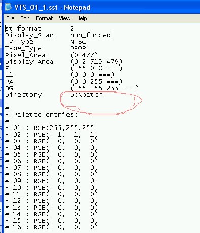

Thank you for the help. I looked at the Muzman log. (See screenshot 1 and 2) I think I found the problem (I named Sst folder "bat" instead of "batch". I am using Muxman again to see if this solves the problem. When I loaded Muxman this time (see screenshot 3) I got notation, "List of 938 bitmaps" , before I just got the word "free".
Right, I didn't even mention anything about the paths having to match up as it's sort of a given that nothing's going to happen if they're messed up.
Also, in that first pic you see the BMPs are numbered the wrong way. I explained the right way before.

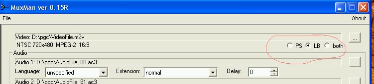

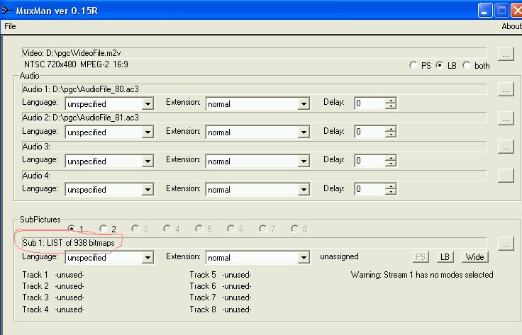

I hope you selected Wide and LB Modes in Muxman before doing the mux. You might also upgrade to ver. 16.6 as that warning is now in red. -
Success. Apparently Muxman didn't care that the BMPs were numbered 1,2,3..10,11,12..100,101,102...

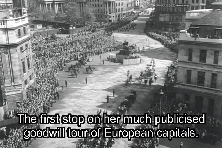

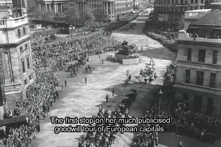

I am not sure what you mean by "selected Wide and LB Modes" in Muxman. I just used the default that came up. (See screenshot 1). Orginal DVD (screenshot 2) and increased size subtitles DVD (screenshot 3). Screenshots taken with Media Player Classic.
Then I learned something also. Back when I was starting to crop and/or resize the BMPs, I sometimes had problems making it work, and decided one reason was the way the BMPs were numbered. I guess it doesn't matter how they're numbered, but that they're numbered the same way before and after.Apparently Muxman didn't care that the BMPs were numbered 1,2,3..10,11,12..100,101,102...
I was referring to your earlier Muxman pic where it says, "Warning: Stream 1 has no modes selected". If you have a 16:9 DVD, and that's what Muxman says even though Roman Holiday is supposed to be 4:3, and you have one subtitle stream, and I think you do, then after loading the SST you have to hit "Wide" followed by "LB". But if you got subs, then I guess you did that already.I am not sure what you mean by "selected Wide and LB Modes" in Muxman.
That is peculiar, though. The pics show a 4:3 video, but Muxman shows a 16:9 video.

I've use Muxman a number of times and never touched those buttons , PS, LB, Wide. I'm not sure what they do.
1) What would happen if they were incorrectly selected?
2) What is the procedure to know which ones to select?
Also, I have another question. When using Irfanview for the batch crop, I had a very time consuming job (about an hour) finding which numbers should be used in the crop before I arrived at numbers that produced a good crop. ( See screenshot). I seemed to just have to guess the numbers by trial and error. I used one BMP and kept trying different numbers until the subtitles were bigger and also positioned correctly on the screen. My question is, is there any faster way to find the numbers that give a good crop? Possibly another software instead of Irfanview might be better? Normally, cropping just involves sliding the mouse, but with Irfanview batch processing, you need to fill in those numbers. I suppose the numbers that I have already found (see circled numbers in screenshot) would give me a ballpark estimate for cropping any other movie, is that right?
EDIT: I have found that both CROP and RESIZE should be ticked, and Pal movies should use a resize value of
720x574 (width x height) and a CROP height of 396 (instead of 300 for NTSC). Below screenshot settings is for NTSC.
You didn't select anything, but left the warnings in place and went ahead and muxed? I didn't think you'd get any subs at all. However, maybe you getting subs has to do with that movie, based on the pics you showed, being 4:3. But that still doesn't explain why it says 16:9 at the top, and why you got the warning in the first place.1) What would happen if they were incorrectly selected?
If it's 4:3, you just select the subs once and that's it. If it's a 16:9 movie, and if you have only one stream, you load it, hit "Wide", followed by hitting "LB". Each 16:9 track must have 2 streams. Sometimes they're the same one (and you hit "Wide" followed by "LB"), but often retail DVDs have one stream for display on a 16:9 TV set and a different one for display on a 4:3 set. I usually create 2 streams myself when preparing subs for a 16:9 DVD. In that case you load the 16:9 one and hit "Wide". Then you load the 4:3 one and hit "LB".2) What is the procedure to know which ones to select?
Sorry, but as I said before, I know nothing about IrfanView. But if, for example, you want to increase the sub size by 25%, you crop away 20% of the BMP. 20% of 720=144, so you'd crop 72 pixels from both the left and the right. 20% of 478=96. I think I'd crop most, if not all, from the top, maybe 80 and 16. Then resize the resulting BMP back to 720x478. You increased the sub size by more than 25%, it looks to me, and they look fine. Using those figures, if and when you have a similar project in the future it should go much more quickly. -
I wasn't aware that 16:9 required 2 streams. And I've never paid any attention to those warnings.
