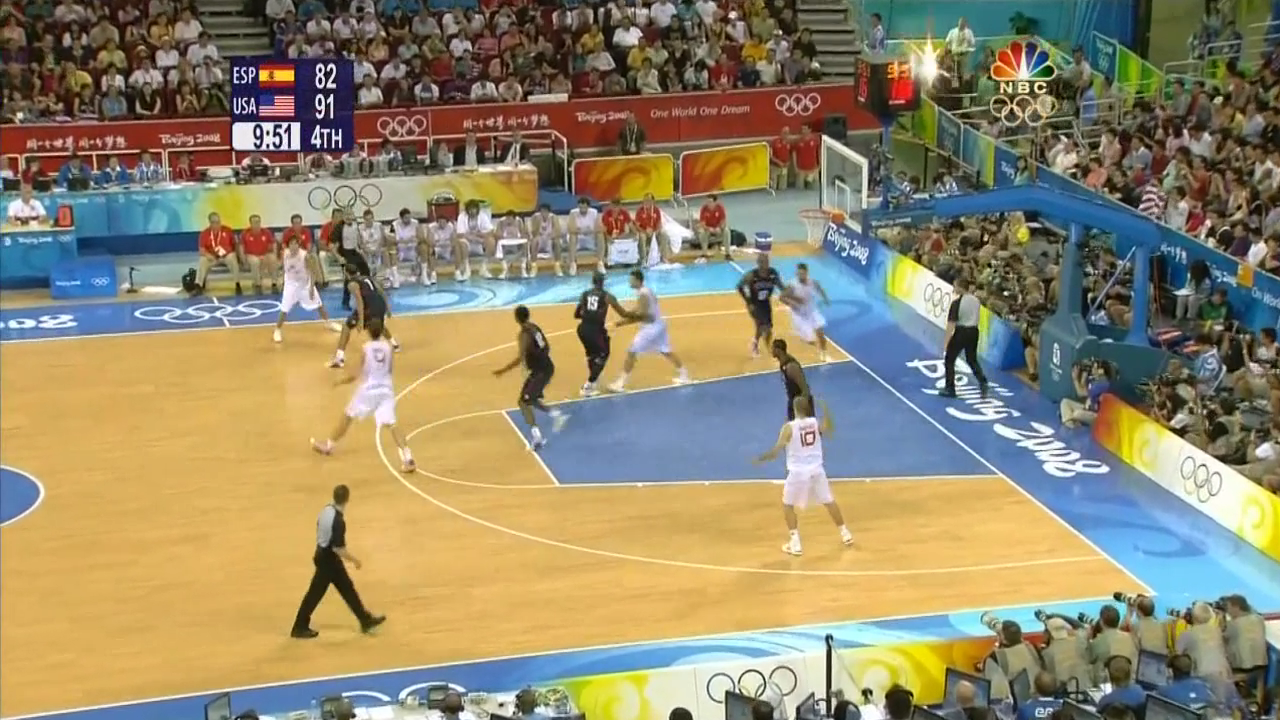

It might just be the way you are capturing the images.Originally Posted by senorroboto2k5
In my case I use VirtualDubMod as it has a feature that allows you to save a frame directly to a PNG image file. It can natively load the m2v file that HCenc spits out so getting a snap shot of that is easy. To get a snap shot of the source I use my AviSynth script (the one I use to encode the source with HCenc) but I delete any filtering or resizing so I get a "raw" unprocessed image from the source.
When taking a snap shot from the m2v file try and do it from an "I" frame aka a key frame. The "P" and "B" frames will never be as sharp as an "I" frame. That is just how MPEG-2 works.

The blurriness has little to do with the resizing filter. It is the way you are viewing the videos and the way you are creating snapshots. Keep in mind you are reducing the frame size from 1280x720 to 720x480. You are losing nearly half your resolution. Of course the smaller resolution will be much fuzzier when viewed full screen. You need to stop posting snapshots that are resized from the videos' native resolution. Use a program that gives you one-to-one pixel mapping in the snapshot. Post a 1280x720 image of the source, a 720x480 image from the resulting MPG file. 800x500 screen dumps from WMP are extremely unhelpful

OK sorry I've been ignoring the "right" way to capture the images...
Source
DVD
^They're being resized
It does look pretty fine. Almost dead on.
Still, there's a difference in watching them on WMP and VLC. Is it because it alternates between I frames and non-I frames? Or is it just because there's something wrong with comparing the full-screen source and the full-screen MPEG2?
Anyway I'll try to cut out a few seconds and post it on here. Does it matter where I upload it? Sendspace or rapidshare OK? -
