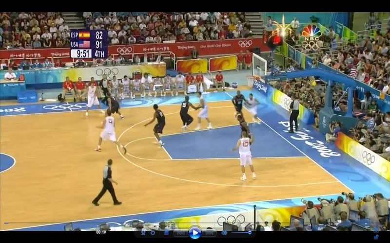

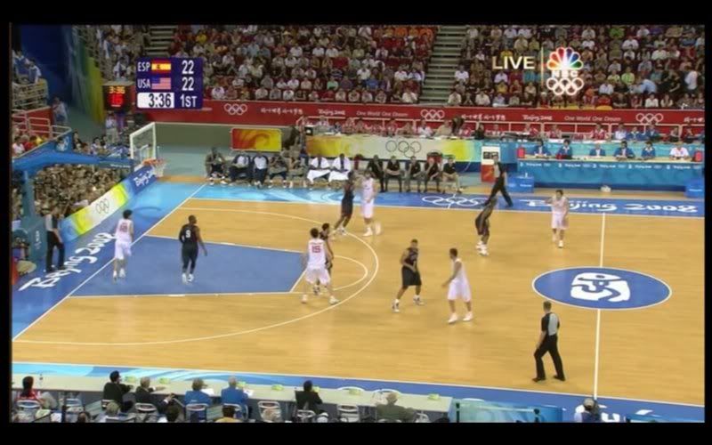

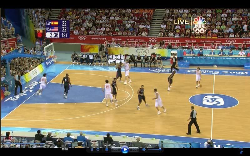

	I think this is about as close as it will get, but I'll post it up to make sure.
 SOURCE
 DVD
 Again, I know that the quality will be noticeably lower. Just making sure this is about as low as it's supposed to be.
	Can't tell without motion but you are in the ball park. Recommends: Kiva.org - Loans that change lives.
 http://www.kiva.org/about
	Yeah, those screens pretty much tell the story... the essence is there.

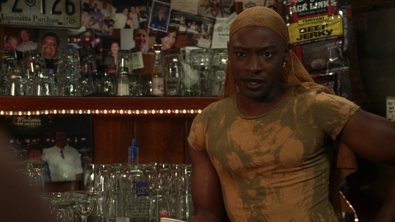

	Here is a before and after I did myself:
 720p (1280x720) H.264 video frame capture (raw frame at 1280x720 which is 1:1 16x9 WS):
 480p (720x480) MPEG-2 DVD spec video frame capture (resized to 852x480 for 1:1 16x9 WS):
 480p (720x480) MPEG-2 DVD spec video frame capture (raw frame at 720x480 anamorphic 16x9 WS):
 The MPEG-2 DVD spec encoding was done using DGAVCDec, AviSynth and HCenc and here is the AviSynth script I used:
 Pretty simple, right? I guess it helped that the file was already 23.976fps and I was going for NTSC DVD so I didn't need to do much of anything.Code:LoadPlugin("C:\VIDEO\dgavcdec100a35\DGAVCDecode.dll") AVCSource("C:\TRUEBLOOD\video.dga") Lanczos4Resize(720,480,0,0,1280,720)
 - John "FulciLives" Coleman
 P.S.
 I used Gimp to do the 720x480 to 852x480 resizing."The eyes are the first thing that you have to destroy ... because they have seen too many bad things" - Lucio Fulci
	Both of those images have been resized by whatever software you used to make the snapshots. Displaying high resolution video at a smaller size will give a very sharp picture. Displaying a low resolution video at a higher size will give a blurry picture. So we don't know how much of the damage was done by the encoding and how much was done by the snapshot program.Originally Posted by senorroboto2k5
 That said, I suspect the fuzzy results you are getting from TMPGEnc are worse than what results from the programs bilinear resizing filter. You may have some other problem.
