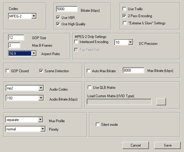

I had audio/video sync problems after encoding the video and assuming that it is 59.94. Below is the code that I used to encode the MP4 file. I have attached the settings I have used for Quenc. Should I be calling a Avisynth function to force audio synchronization? I may try with HCenc, but I don't know what to do for the audio.
Code:DirectShowSource("D:\Cowboys at Browns.mp4") LanczosResize(720,480,88,0,592,432) SelectEven() ChangeFPS(29.97)
DirectShowSource("D:\Cowboys at Browns.mp4",convertfps=true,fps=29.97)
