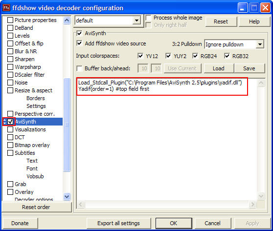

hamidi2 - did you try using avisynth scripts yet? Theoretically DirectShowSource() should work as jagabo suggested, if the vdub directshow input driver worked. But as shown in the above example sometimes that is not the case with many errors in the stream.
If you used avisynth to frameserve, you can have access to yadif (or TempGaussMC_beta1), have better filters, avoid the colorspace conversion, and have similar video quality to the output you had with avidemux
EDIT:
Since you are using the directshow input driver and ffdshow to decode, ffdshow has many postprocessing options that you can use. You can use avisynth scripts and yadif, for example (see screenshot). It has built-in ones also (you can activate when checkmarking the Deinterlacing box). TomsMoComp is a motion sensitive and gives similar results to Yadif IMO.
Once you make any changes to the ffdshow configuration, you have to re-open your file in vdub with the input driver to let the changes take effect
Do not forget to reset your configuration after you are done. This is how many directshow encodes go "bad"; because all the filter effects are "passed thru" and sometimes filters conflict or compound their effects.
The better option would still be using a dedicated .avs script in "fast recompress" mode as jagabo suggested, so you don't lose a bit of quality by colorspace conversion - but I'm not sure if you will be able to keep sync on your particular clips with that method.
