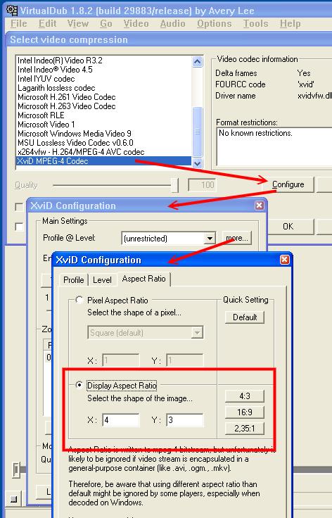

  18. Originally Posted by hamidi2
    the resulting converted video by vdub is not in width as the same as the original one. vlc doesn't give me the properties. vdub and avidemux say that it's a 544x576 video, while when it's played in vlc width is visually more than height.
    MPEG files have a Display Aspect Ratio (DAR) flag. The DAR flag tells a player what final aspect ratio should be seen on screen, regardless of the frame dimensions with which the video is encoded. Your video is encoded with a frame size of 544x576 and has the DAR flag set to 4:3. VLC is automatically scaling the image to match the DAR flag.
    VirtualDub's default behaviour is to map the source's pixels one to one with pixels on the monitor. This lets you see each pixel without any distortions or artifacts created by resizing. If you want to see the frames with the correct DAR, right click on a pane and select the DAR. Note that VirtualDub uses quick dirty resizing filter for display (equivalent to Nearest Neighbor in its Resize filter) so it won't look great.
    When encoding to Xvid AVI you can retain the frame size and set Xvid's DAR flag or you can resize the frame yourself and use square pixels. Not all players will respect the DAR flag so resizing the video is more common. After deinterlacing you can resize your 544x576 video to 768x576, 544x408, 512x384, 448x336, or some other 4:3 ratio.

    i didn't see anything in the context menu of vdub named DAR. i just found 4:3 TV which made it the same resolution i wanted. u meant it will keep the DAR flag in the destination converted avi file? if so, i've not to worry about resolution? but i think as far as i want to be able to play it properly by TV and also vlc, it's better to make the destination avi file as i wish it to be. don't u think so?

  20. Originally Posted by hamidi2
    It's safest to resize to a 4:3 frame size.
