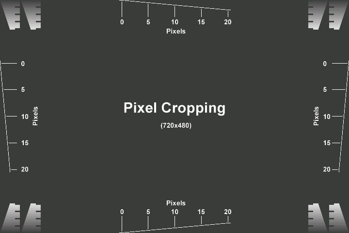

Make yourself a DVD with an overscan test pattern:
Actually, that pattern may not work well because the overscan is typically more than 20 pixels. -
I apologize for being late with my reply. I was busy for awhile, then I forgot for awhile, and then I was busy again. Anyway, I finally burned it as a 16:9 DVD and had a look. The pic was taken with my wife's cell phone camera of the DVD being played on the TV set. I apologize for the crummy pic, but didn't realize until later that the camera was moving as I took the picture. I don't guess you have any trouble seeing there's no overscan.
Costco and Sam's Club call the TV the Sony Bravia KDL-46VL130. At most other places it's called the Sony Bravia KDL-46V3000. The DVD player is an Oppo DV-981HD feeding the TV set over an HDMI cable. My guess is that no overscan is common when viewing DVDs over HDMI to LCD sets. One factor often neglected is the fact that the majority of DVD players crop some pixels before sending the picture to the TV set. Some of the lost picture that gets blamed on the overscan might not be because of overscan at all.
In case others might want to find out how much, if any, their overscan is, I've prepared 2 DVDs, one for 4:3 video and the other for 16:9 video, each 30 seconds long. Zipped up they're each 52 KB. Unzipped they're each just under a MB. Unzip them and you'll find the IFOs, BUPs, and VOB in the VIDEO_TS folder, along with the AUDIO_TS folder, ready to burn using ImgBurn to a DVD-RW (or a CD, if your player can play Mini-DVDs).
crop_test_16_9.zip
crop_test_4_3.zip -

Even though the pic itself still says 720x480, I resized it to 720x576 before making the 2 PAL DVDs. I just tried the PAL 16:9 one in my own player and it still shows no overscan. Maybe PAL people playing both the NTSC version and the PAL version will have the same amount of overscan, I don't know. And as jagabo mentioned earlier, the 20 pixel max that the picture shows may not be enough for a lot of people, especially those using composite cables to connect their player to a CRT television set.
Also, if you play just the 16:9 DVD VOBs, they'll play as 4:3. That's because I used the same VOBs for both the 4:3 and 16:9 DVDs, but changed the DAR for the 16:9 DVDs in the IFOs. Played as DVDs they should play as 16:9. Most (but apparently not all) DVD players get the DAR information from the IFOs and not the VOBs themselves.
