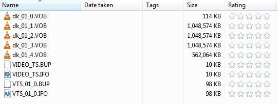

I have a DVD structure that NERO wont add-files to to burn
ive attached a screenshot of said structure...is it right?
Results 1 to 25 of 25
Change "dk" to "vts".
dk_01_0.vob -> vts_01_0.vob
Refer to "what is dvd" in the upper left corner of this page to see the correct naming structure. -
Once renamed correctly (and that includes ALL CAPS), those files need to be in a VIDEO_TS folder off the root. If you need to include other, non-DVD-Video-based files, those SHOULD NOT be in the VIDEO_TS folder, but in some other folder off the root.
Scott -
