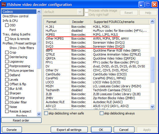

  2. MPC is a directshow player, so you need a directshow decoder to play videos. The most common is ffdshow, you probably have to enable sorenson 3 and possible MJPEG as well in the ffdshow configuration (should read "libavcodec" instead of "disabled")

  4. Don't enable things that you don't need to. There is more potential for conflicts & problems. I only have so many things on my "test" system which has lots of garbage installed.
    I already mentioned you probably need a .mov splitter, a decoder itself is insufficient. You might have to enable MJPG as well (disabled in your screenshot, underlined in my screenshot).
