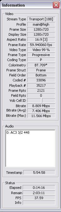

    Here's a screen cap after about 14 minutes.

    So it's exactly as I guessed: 720P with irregular frame pulldown. This is why all the apps are having problems; they don't honor frame pulldown. There's one that does, however: DGIndex! Another one that does is fccHandler's MPEG2 plugin for VirtualDub, which explains why things worked for you that way and also supports my theory about the pulldown handling being the cause. So please try everything again with Honor Pulldown Flags and make some measurements this time, i.e, get the frame count.
    It simply can't be true that there is no difference between Honor Pulldown Flags and Ignore Pulldown Flags when pulldown flags are actually present.

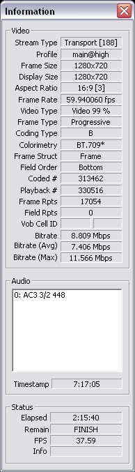

    I'm not getting any errors from the latest DGIndex, but an earlier version warned of something to do with the first few frames of the stream not having the reference I frame, or something like that (I didn't save the error). But in my mind, that didn't account for the vast difference I was seeing, and at worst should have caused a synch off-set that I should have been able to compensate for with DelayAudio().
    I let the test run to conclusion and here are the results. Very close to the numbers that I was seeing and definitely explains the difference. I can't wait to try it on the real thing for editing.

    Yeah, I didn't think it had anything to do with my problem. Setting DGIndex to respect the pulldown flags resolved the problem. The editing goes much smoother now.
    Thanks for all your help and for developing and providing DGIndex.
