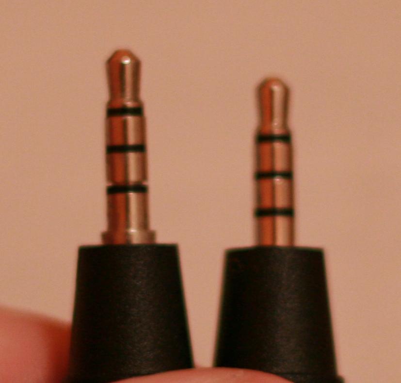

Also, here is a pic of the RCA cables that I am using. I am pretty sure one of them came with the Canon, but I'm not sure which one. I have tried both. Does one of these look right?
Thanks for all the help,
Adam

hook the sharp up to a tv and make sure the tape plays.
try taking the tape out of the canon.

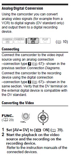

from the manual
