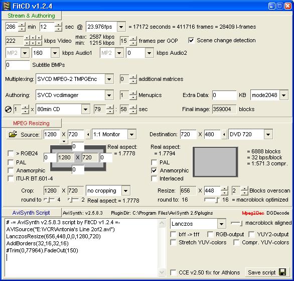

I am trying to compensate for some nasty overscan on my TVs (standard 4:3 TV). I am converting a mkv to DVD compliance. It is an anime with hard-coded subs. The mkv is 1280x720 and very high quality. I am trying to use FitCD to add the overscan borders but cannot find a guide to save the life of me. Could anyone please explain what I should be doing or what all the options in this software mean? After creating the script I run it through CCE-SP2 version 1.00.00.15.
Any help is greatly appreciated.

Thank you for the reply. Couple questions.
When I first load up the video (MKV) in fitcd it gives me an error:
"Can't find the sequence-header of <file name>", however the resolution does display correctly. Should I just ignore it?
Also I load up my mkv in fitcd and I know the video is widescreen but it doesn't automatically check anamorphic (which I thought meant widescreen) though it does shows 1.7778 as the real aspect ratio. So leave anamorphic unchecked on the source side?
Why do I check anamorphic on the destination side even though it's going to be burned to a dvd and played on a stardard 4:3 TV? -this probably has to do with me defining anamorphic incorrectly.
Also when I mess around with the "blocks overscan" option the real aspect ratio changes on the destination side. At this point do I mess with the resize option so that it equals the source aspect ratio?
Thanks! -
I don't think FitCD can read MKV files. Just enter the values by hand. Since your file was 1280x720 I assumed it was square pixel 16:9.
The anamorphic option will use the entire 720x480 (minus the overscan blocks) 16:9 frame for the video. If you don't use it the 16:9 video will be letterboxed into a 4:3 frame. Both will look similar on a 4:3 TV (the DVD player will letterbox the anamorphic version as it's played back) but a widescreen TV will fill the 16:9 screen with the anamorphic version. Using 4:3 instead of 16:9 give you both letterbox and pillarbox bars on an HDTV.
The real aspect ratio changes because the overscan blocks are optimized to keep the image aligned to macroblock boundaries. Keeping the image on macroblock boundaries help encoder efficiency and helps keep artifacts from appearing at the edges of the image. So it trades off a little aspect ratio accuracy for better image quality. -
So what about checking anamorphic on the source side if I know its widescreen 16:9? Yeah or nah?
So if I mess around with the options under the destination side do I need to go to resize options and change them until the Aspect ratio matches the source? -
No, of course, or didn't you understand jagabo's reply? It's not anamorphic. It's widescreen, yes, but not anamorphic. Those are 2 different things.So what about checking anamorphic on the source side if I know its widescreen 16:9? Yeah or nah?
It's 1:1, so you start with 1:1 Monitor for the Source. Since you'll be encoding for 16:9 DVD, you check Anamorphic on the Destination side.
Do it just as in his pic. The destination DAR doesn't match the source DAR....do I need to go to resize options and change them until the Aspect ratio matches the source?
Here's the FulciLives guide to using FitCD:
https://forum.videohelp.com/topic296341.html#1487285 -
Sorry it's late and my head hurts...gotta learn to read things more carefully. Thanks for your help!
