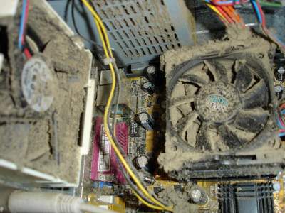

  2. Sounds like your PC is overheating
    Check your temps with coretemp or similar temp monitoring program.
    Reset your overclock to default settings if it is overclocked.
    Clean out the dust and fans from your heatsink, ensure adequate airflow
    Consider investing in an aftermarket HSF if you can't get temps under control

    The item that sounds odd is losing the C drive. I would agree it sounds like a overheat problem, except for that. Maybe it shut down a few too many times when the C drive was writing. That could corrupt the drive. But normally doesn't physically damage it.
    But another possibility is a failing power supply. If cleaning out the dust cools it down and solves the problem. great. If it it looks like this inside, then I think you may have found the problem :
    If a CPU overheats a lot, the thermal compound on the heatsink may have hardened and is not as efficient. If the CPU temps are still high after cleaning, you may still have a problem. You might consider pulling the HS, cleaning and applying new thermal compound.
    I would also go into BIOS and see if you have a hardware monitoring page. That usually shows voltages, fan speeds and CPU and case temps. You can also check the temperature of the air coming out of the power supply. If it's hot like a hair dryer, blow out the dust. If still hot, consider replacing it.
    EDIT: If your P4 CPU is a Prescott, that could explain the overheat is they run hot anyway and good cooling is important. A program like CPU-Z will tell you the CPU model and what speed it's running at. http://www.cpuid.com/cpuz.php

    No, my computer looks clean inside. But the air from the power supply vent at the back is hottish.
