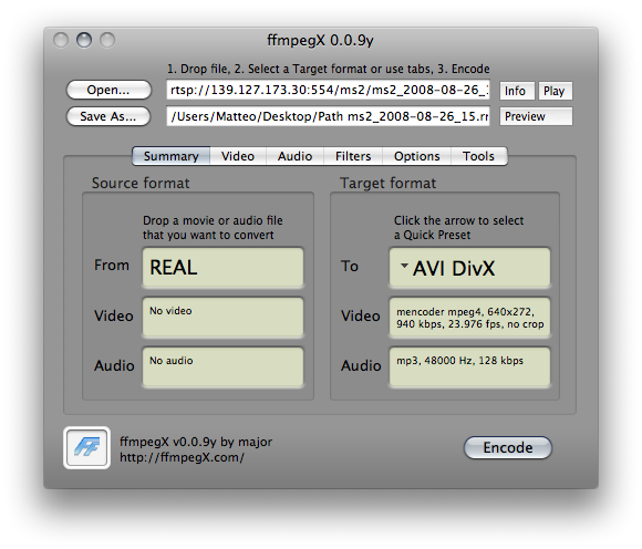

I am trying to use ffmpegx to convert some real player (rm) media into avi so that i can watch it using quicktime. i have used this program in the past with success, but now am having difficulty. i am using 0.0.9y version, have all the binaries installed, along with completing the download and install of the Mac OSx 0.86 binaries from the Mplayer website. i have copied the codecs from the 0.86 install into the library of application support for ffmpegx as "reallib."
The problem arises when i try to open the rm file in ffmpegx. if comes up a "REAL" as usual, but it says there is no video and no audio. the file opens fine in real player, with audio and video, but not in ffmpegx. i know the problem is not with what i have installed, cause i have used all the appropriate Intel files, but what could i be missing? when i installed everything and went into the application support, there was no "reallib" file originally.

it was not helpful, unfortunately. when i try to open the file in ffmpegx, it comes up with "no video" and "no audio" on the right left side. it seems to be a problem in reading the file, not the conversion into an AVI. the rm file is not empty; when i open it in real player, it plays perfectly.
You are converting from an online source. The video content isn't local on your hard drive. The protocol and/or the server at the other end may hinder a smooth handling by MPlayer. Perhaps even by design.Originally Posted by mgarman14
My setup of ffmpegX does usually handle RM as it should. I couldn't get ffmpegX to handle any Real video from Upstate.edu either.
You are at the mercy of the content provider -- they can do things (either on purpose or by accident) that will prevent successful on-the-fly conversion. Handling the general case of converting streaming media can be a bit tricky, so rather than wondering why it no longer works right, perhaps a better question is why it used to work at all.
Your most reliable approach is to download the content onto your HD first, and then convert once the file's all there. If you still have problems, post back, and we'll commiserate.
I noticed this server now uses .ram files with URLs likeOriginally Posted by mgarman14
rtsp://server_ip_address:554/directory/filename.rm?cloakport=81,554
The last part of the URL suggest they do some trickery with server ports for whatever reason. (I think it it meant as fall-back: if port 554 fails, try port 81 -- that will make it go through most firewalls.) Maybe mplayer failed because it couldn't understand that last part of the URL.
When I tried to modify the .ram file to contain a URL like
rtsp://server_ip_address:81/directory/filename.rm
then ffmpegX was able to capture/convert the first 245 seconds. Maybe mplayer mistook a buffering pause for an end-of-stream, because the converted output file ended halfway a sentense.
